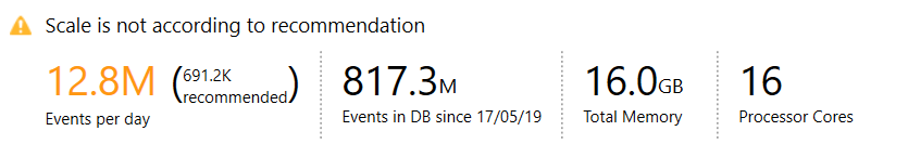

My SMS is R80.10,provide smartevent service,but it have as follow attention:
"Scale is not according to recommendation"
What does that mean?
@Jeff_Gao , taking it at face value, it looks like you are over-utilizing the SmartEvent server 20 times it's recommended capacity and capabilities.

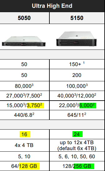

Without knowing this data, I can point you to this document, that should've been used for the sizing information:
https://www.checkpoint.com/downloads/products/smart-1-security-management-platform-datasheet.pdf
Look for "sustained logs" and " burst" data and compare that to the numbers you are seeing n your warning.

@Jeff_Gao , so your VM, running Management Server with SmartEvent, except for RAM is roughly rated at 3,750 sustained logs per second:
2 SmartEvent configuration
3 In Multi-Domain configuration
This translates into 225,000 logs per minute.
Your LogsPerMinute.txt shows:
# cat logPerMinute.txt
Rounded log time: 18-06-2019 09:55; Log count: 27078
Rounded log time: 18-06-2019 09:54; Log count: 328174
Rounded log time: 18-06-2019 09:53; Log count: 280652
Rounded log time: 18-06-2019 09:52; Log count: 347959
Rounded log time: 18-06-2019 09:51; Log count: 297595
Rounded log time: 18-06-2019 09:50; Log count: 301089
Rounded log time: 18-06-2019 09:49; Log count: 303587
Rounded log time: 18-06-2019 09:48; Log count: 322227
Rounded log time: 18-06-2019 09:47; Log count: 288479
with each line except topmost one, exceeding rated parameter of the capacity you have provisioned.
Specifically, the RAM you have allocated is not even close to the specs of the hardware servers dedicated to processing same number of logs per minute.
If you want to have a chance at crunching same number of logs, see if you can match the specs of the 5150 appliance and that your storage IOPs are on the higher end of the spectrum.

In a nutshell, yes. Hike it up to 64GB at least to see if the situation will improve.
