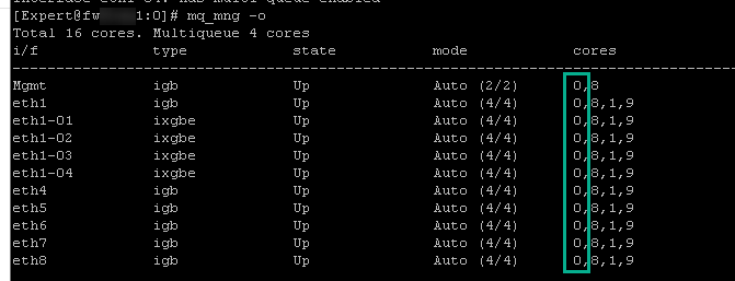

What's interesting is that CPU usage jumps fairly high with high wait time on CPU0 which is only set to be used for MQ. Screenshot below is from a standby member so there's not a lot of other processing there
Just to confirm affinity settings CPU0 set only for MQ

That is really strange to see such a high wa (waiting for I/O) on a dispatcher core instead of a worker core.  Having that core getting blocked 86% of the time waiting for some kind of event related to your route display might cause other problems.  Do you have any VTIs?  Maybe getting stuck there resolving the interface name or something?  Any loopback subinterfaces or other nonstandard interfaces defined in Gaia?  If you try "show route summary" does it return immediately as that display does not involve resolving interface names?
I really doubt it is something in SecureXL, Dynamic Dispatcher, or SoftIRQ (which would would hang in si space) even though those are present on the dispatcher core that is getting blocked...
